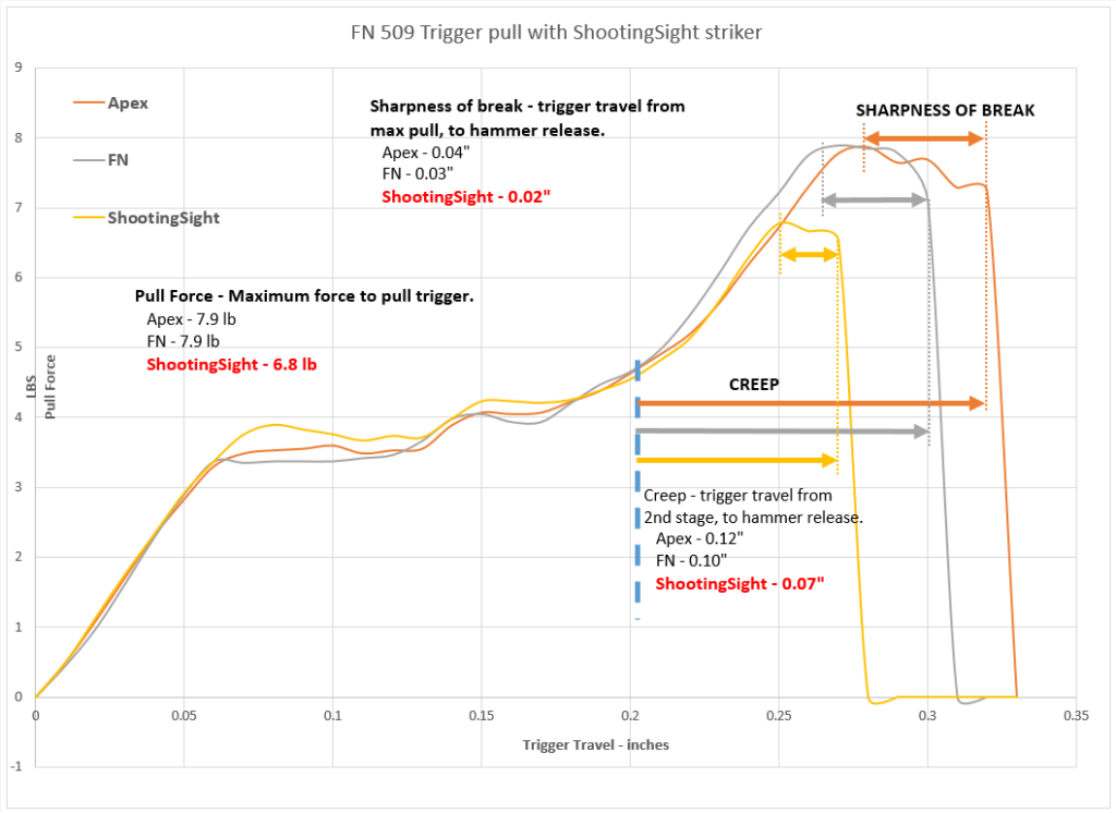

how much shorter than stock is the the shooting sight striker “tail” I’m curious the difference percentage in sear engagement. Thanks.
Don't remember exactly - I did this development several years ago, where I took a stock sear and ground 0.010 off the tail, tested it, took another 0.010 off .... and repeated till it failed, then picked a number that was less, but not crazy less. The best way to compare it is to look at the creep - the distance the trigger travels between hitting the second stage, and the position the hammer releases. In my testing, I was 70% of the creep seen in the stock striker.
Just received an updated shooting sight striker with a longer tail and it works flawlessly with the current apex sear. No more reset issues. I have updated my post using the newer striker.
