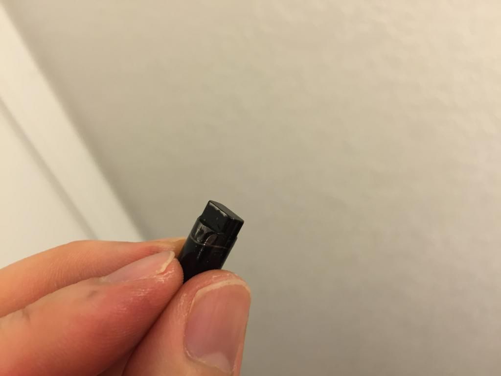

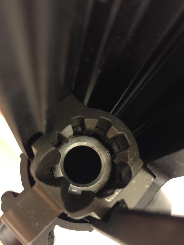

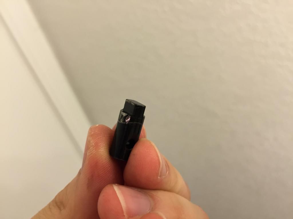

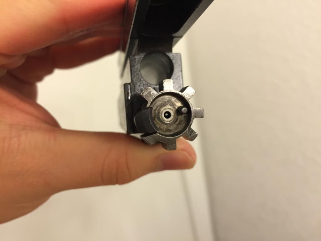

Here are some pictures of stuff I realized I left out in the video or weren't super clear.
Feel free to be brutally honest if it's me being an idiot. I think I've followed the proper assembly/disassembly steps so I'm really at a loss on the cause of the problem.

The cam pin looks pretty chewed up in the first picture, that could cause the bolt to hang up a little when you move it back and forth (like you showed in your video). I doubt that would keep the bolt from unlocking though. It's probably a side effect of whatever is causing your problem.

I think several people have pointed to the most obvious solution that the tip of the firing pin is getting stuck in the hole of the bolt face.
Remove the pin and the bolt, and push the pin into the back of the unassembled bolt, and see if you can get the tip of the firing pin to extend out the face of the bolt. I'm sure there is a published number for how far it is supposed to protrude, and I'm guessing it is about 0.050. You can measure it with a calipers. The assumption is that the very tip of the pin is either bent, or too fat to fit comfortably in the hole, so when you pound it it with the hammer, it does not want to pull back out.
Get a sharpie, color in the tip of the firing pin, put it in the back of the bolt to verify it is poking all the way through, then take it out and see where the sharpie ink is rubbed off. You could try it by dry firing as well.
