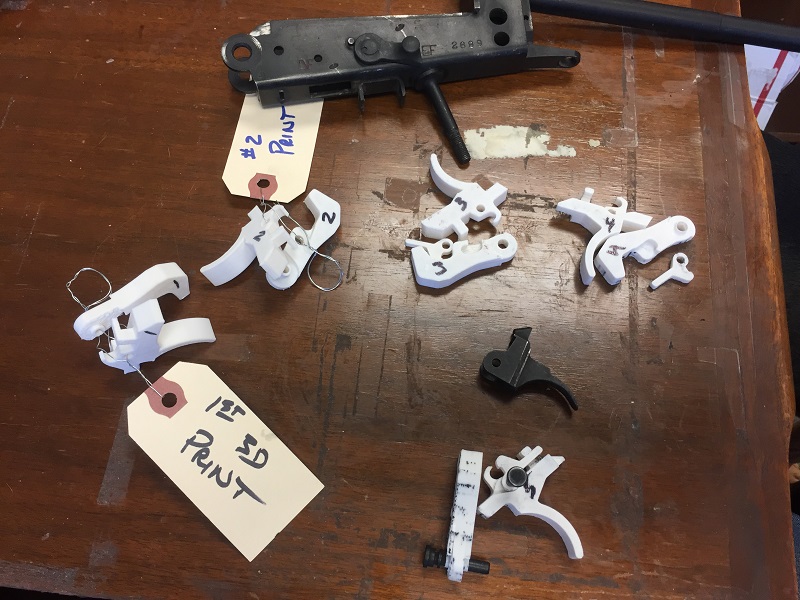

FAL was on my radar, but low priority, and a difficult design to do in the space there was. The 'slip sear' design (there's probably a technical name for it that I don't know) tends to place the pivot holes very close together, so fitting in a disconnector is difficult. Well, last weekend someone asked me about it, and as I was describing the challenge, it suddenly hit me how to do it. So being the ADD guy I am, and having a shiny new idea, I shelved al the stuff I was *supposed* to be working on, trashed the previous CAD models I had started, and started over.
I've now 3D printed 5 iterations (in plastic), and I like! It's come together nicely. Tomorrow I'll start to cut the first one in steel. I think this will be an excellent trigger.
Only outstanding technical issue is I need to fit the hammer spring. I do not like the FN straight coil spring. I prefer the clock spring approach, like the AR uses.

Glad I found this thread! Art, we talked a bit on the FALFiles a while back about this topic. L1A1 (aka "inch") and FAL (aka "metric") hammer, trigger, and sear parts are mostly incompatible. See the full list here https://www.falfiles.com/forums/showthread.php?t=240806
FALs are many times more plentiful than L1A1s, so you're on the right track there. I have 4 FALs and 1 L1A1, but I'd guess it's more like 30:1 in the real world.
Let me know if there's anything I can help with. I have a spare FAL lower I could send you and other bits as well, if it would help the cause.
