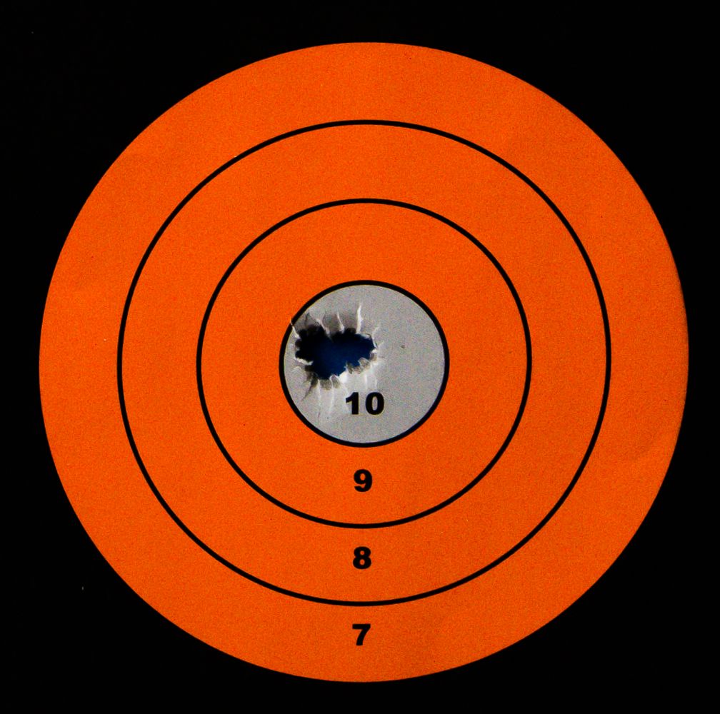

It really has been a great rifle, and after having it bedded & painted by short action customs, it was a consistent .5 MOA rifle with FGMM factory rounds. I also used Hornady Steel Match .308 for linking/steel targets, which gave .75MOA groups. Here is a typical FGMM 100 yard group:

So after shooting 100 rounds at all different powder weights, here were the best 100 yard 3 shot group results:
38.5 grains of IMR 4064:
41.0 grains of Varget:
Needless to say, I'm totally jazzed! These are the tightest groups I've ever shot with this rifle. My first ever .25 moa group!! Bottom line, if you are on the fence about reloading, definitely do it. It made a big difference in my case, plus it’s a lot of fun!
