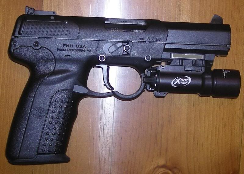

BTW: The Surefire X200B is my favorite light for the FiveseveN. Its as bright as the X300 and unlike the X300 (which is longer than the X200) it sits flush with the end of the barrel.
I am in the same situation...so whats the best light (fit wise) for the Five Seven IOM?
"Fit" wise for an IOM, it would have to be the Surefire X200B using the factory Glock/Universal mount ( marked "U" ). The X300 is a great light bits its rather long.
2
Here is what I mean when I say the X300 doesn't fit flush with the end of the gun. See how when it is attached, the X300 sits out further than end of the barrel. The X200 sits flush at the end.
X300
X200
