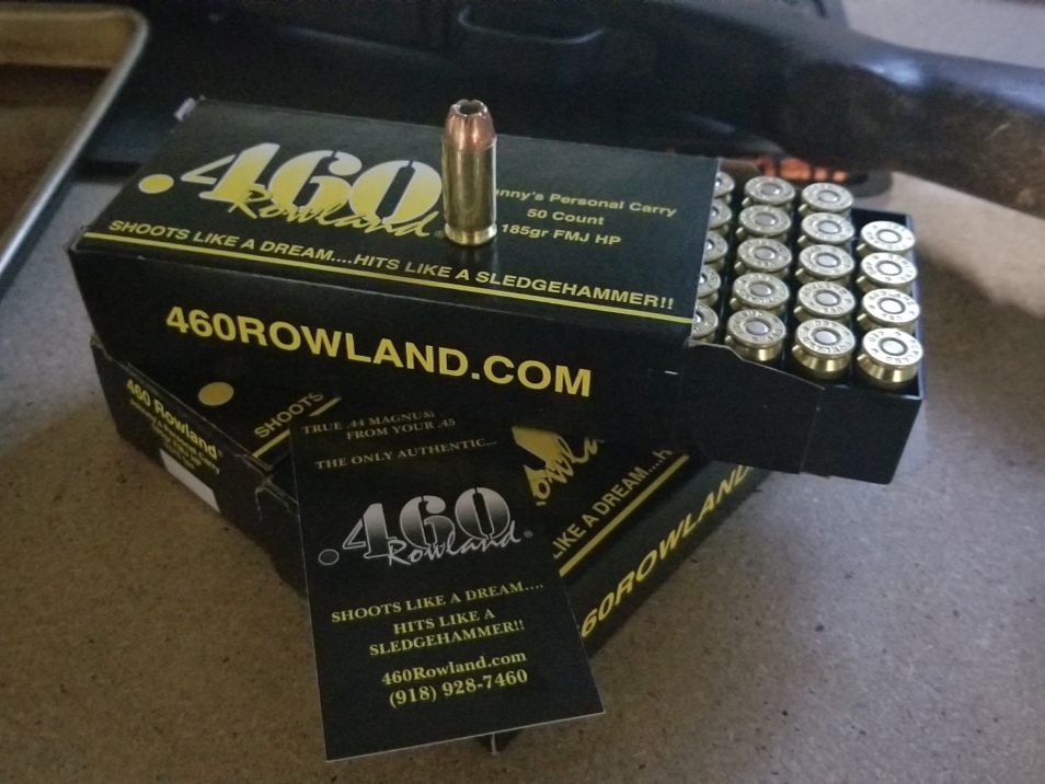

As of today mine has eaten over 3 50rd boxes of Johnny's carry round from 460R and some Underwood 255gr hardcast lead.
The 460R Johnny's carry (~1040 FPE) shows pretty extreme primer flattening as well as flowing. A couple primers look punctured. A real testament to the strength of the 460R starline case, which looks unphased. The Underwoods (~960FPE) show light signs of primer flow but not the expansion into the full primer pocket and breech face like Johnny's carry.
I am in LOVE!!!! I've blown up a 45 before. The spent Johnny's carry should blow the heck up according to the primers and destroy the FNX but these 460R Starline cases are invincible. I haven't loaded my own yet but have 500 new manufacture starline cases and saved Almost all my fired cases. It's tricky to capture them as they like to fly almost strait upward and land 20 feet to the right and 7 to the back - tough to find in the grass or in a pile of 7.62!
