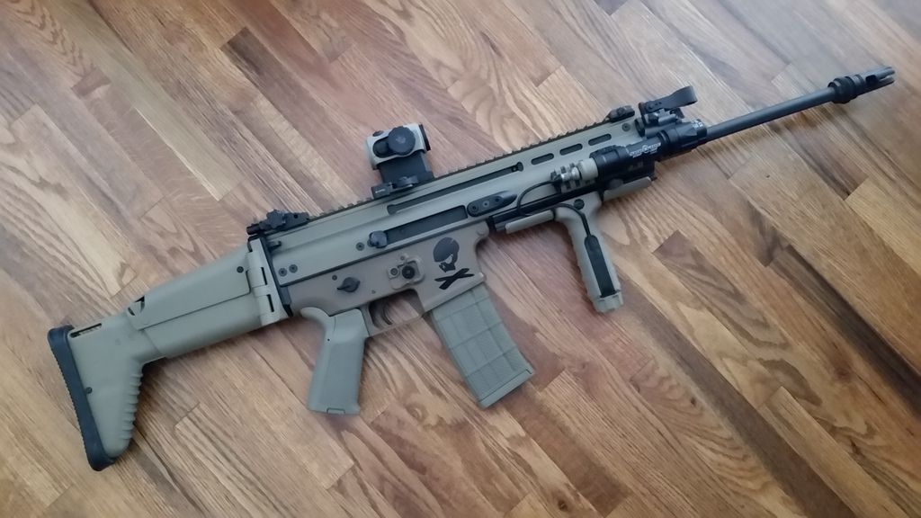

SCAR 16 with MIAD install
Here is my finished MIAD. I did grind down my lower by about 1/16th inch though to get the gaps to fit perfectly (the MOE grip requires about an 1/8 inch). The back strap was obviously ground down as well, but looks good. I still need to grind down the sharp corners that stick out by the trigger guard - apparently the SCAR trigger guard is not as wide as on an AR.
