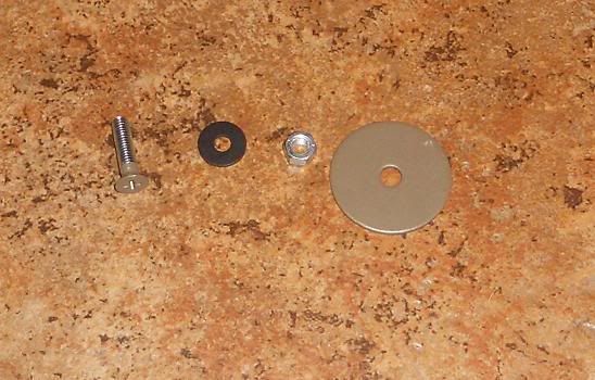

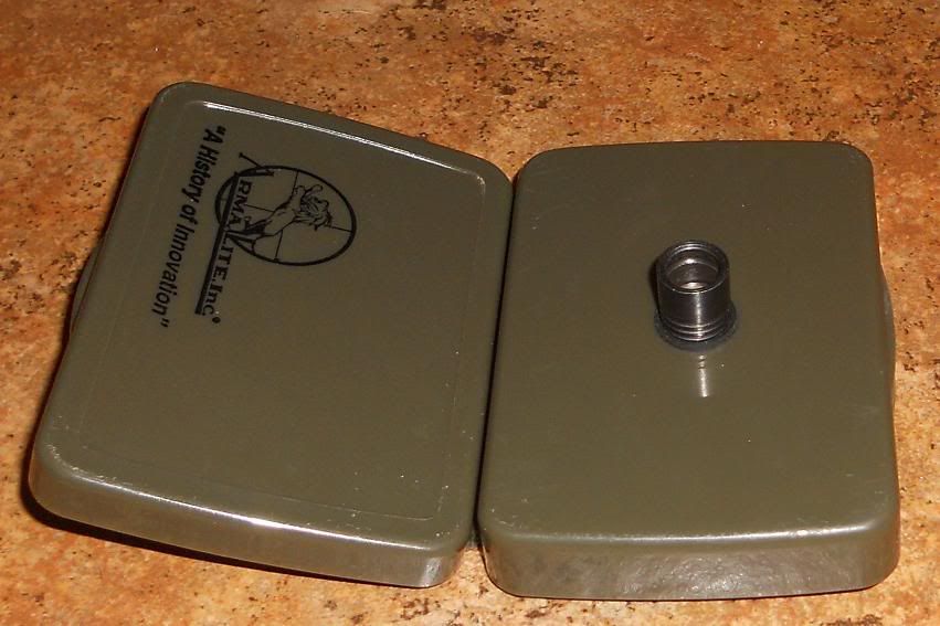

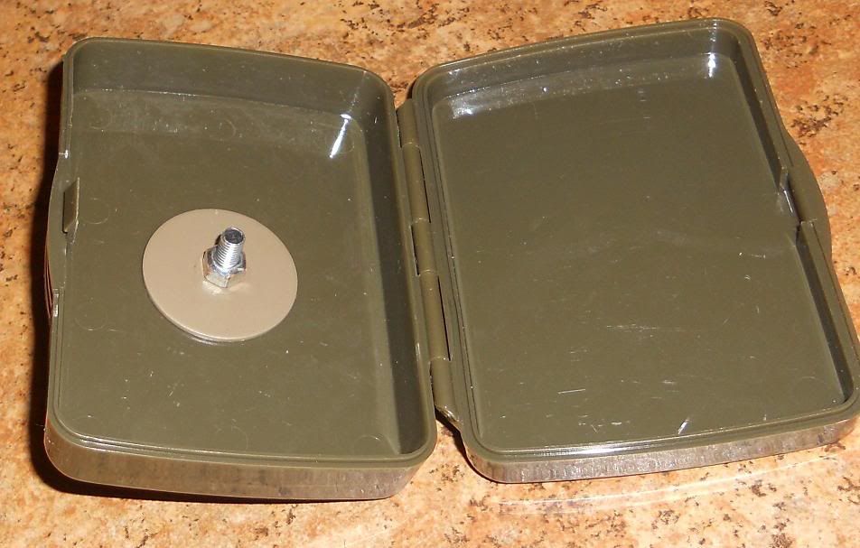

Guys, I am currently running and AR15 with a VTACS sling, using QD swivels and I love the set-up. With a SCAR 16S in my very near future I want to run a similar sling. Knowing that Tango Down will soon be offering aluminum side rails with QD sockets, the front swivel is an easy fix. However, what are you guys doing for the rear stock? Here's my mock-up to install a QD socket on the SCAR stock. It will require that I drill one hole in the stock for the screw. Below are some pictures, as soon as I buy a SCAR I will install on the rifle and get more pics up. Total cost was under $15. The hardware came from Home Depot and I painted the washer and screw head FDE using Brownell's Aluma-Hyde 2. The socket came from Sinclair International. For those of you interested in these parts let me know and I can point you in the right direction.
Initial Mock-Up:
Parts minus socket but showing screw, rubber bushing, lock nut and washer:
Socket installed:
Inside of stock showing washer and lock-nut:
