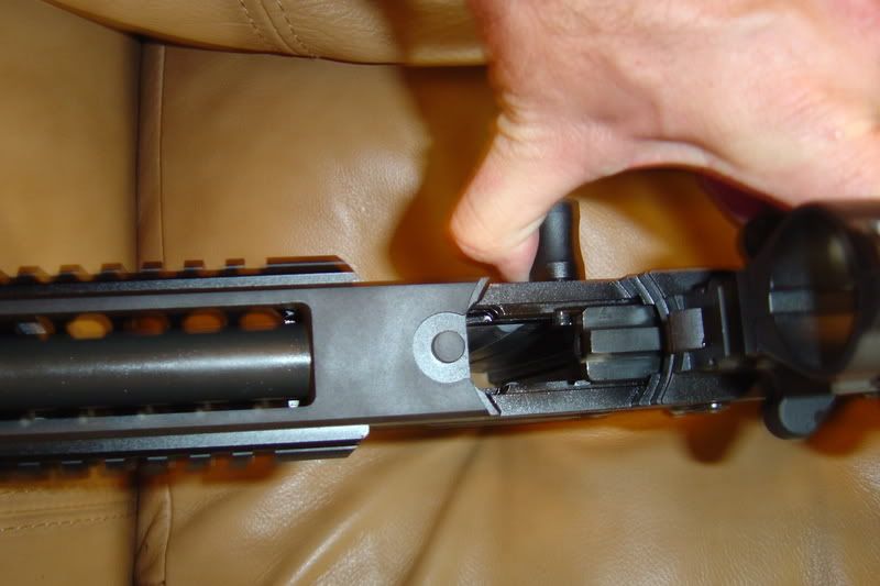

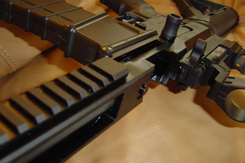

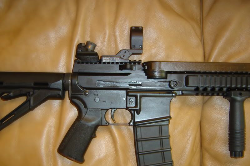

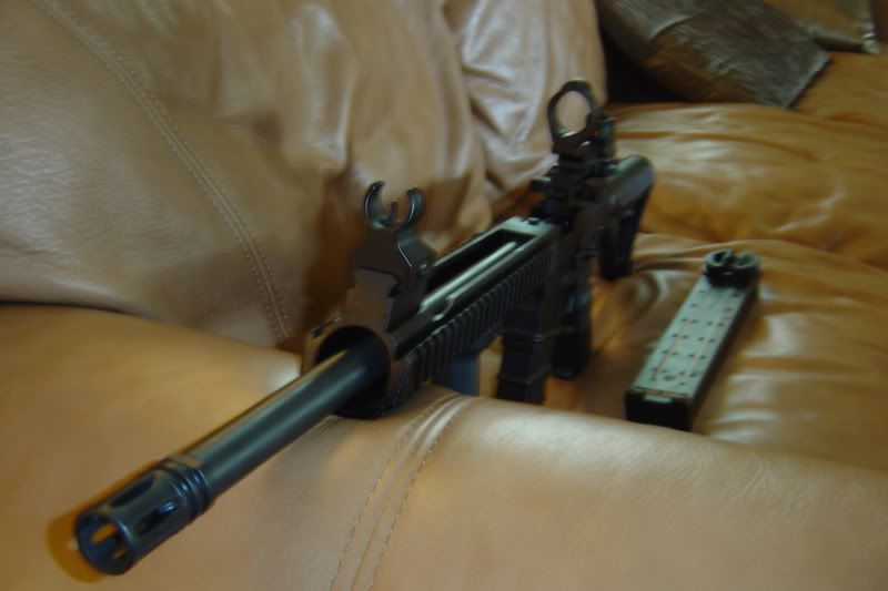

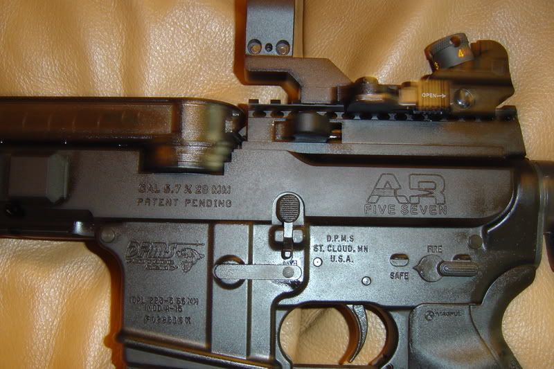

Well this thing is interesting. Its a AR-15- PS90 cross bread. The one piece modular upper snaps onto any AR-15 lower. Allowing you to fire 5.7x28mm with the PS90 50 round mags. I added HK 416 rifle sights. I wanted to use the LaRue Tactical Aimpoint mount in the picture but I think the sight may stick out to far to mag change:( we will see. I just used a DPMS complete lower with a Magpul grip and stock. It has a right side charging handle. The upper and lower color match perfect. I am really impressed with the quality. It still has the bolt open feature like the AR-15. It does utilize the buffer tube with the stock AR spring and a Heavy buffer that came with it. It ejects the spent cases through the mag well. I had a cheap 30 mag that was no good so I gutted it and cut the top off so it will work as a funnel for the spent cases. I purchased the Upper from www.HKSpecialist.net who shipped and I received it over night. Great guy to deal with. Unfortunately I can’t find them for sale anywhere else and I got the only one Gordon had left. The Manufacturer’s web sight is www.57center.com . I put 150 rounds down the pipe today after work with out a hitch. Really sweet accuracy at 50 yards open sights. And it was easy to engage multiple targets with no recoil throwing me off. I cant wait to put a optic on it. I am leaning towards a Aimpoint Micro T-1. Enjoy the pics.....................

thats looks cool, whats the plastic ar 15 magazine for? and do the rounds still eject out of the bottom?
3,590 Posts
Shell Deflector is my guess. I would assume its a gutted out AR mag used to keep the brass from falling into you.

Yup, its a gutted mag with the top cut off. I was interested in using it for a brass catch. But I think Ill have to use a 40 rounder to hold them all. with out the base plate the mag directs the spent brass right in front of my feet............
