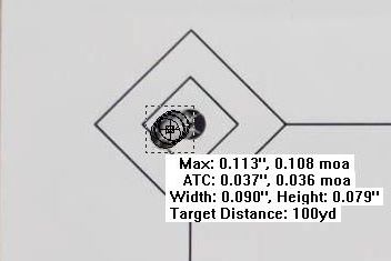

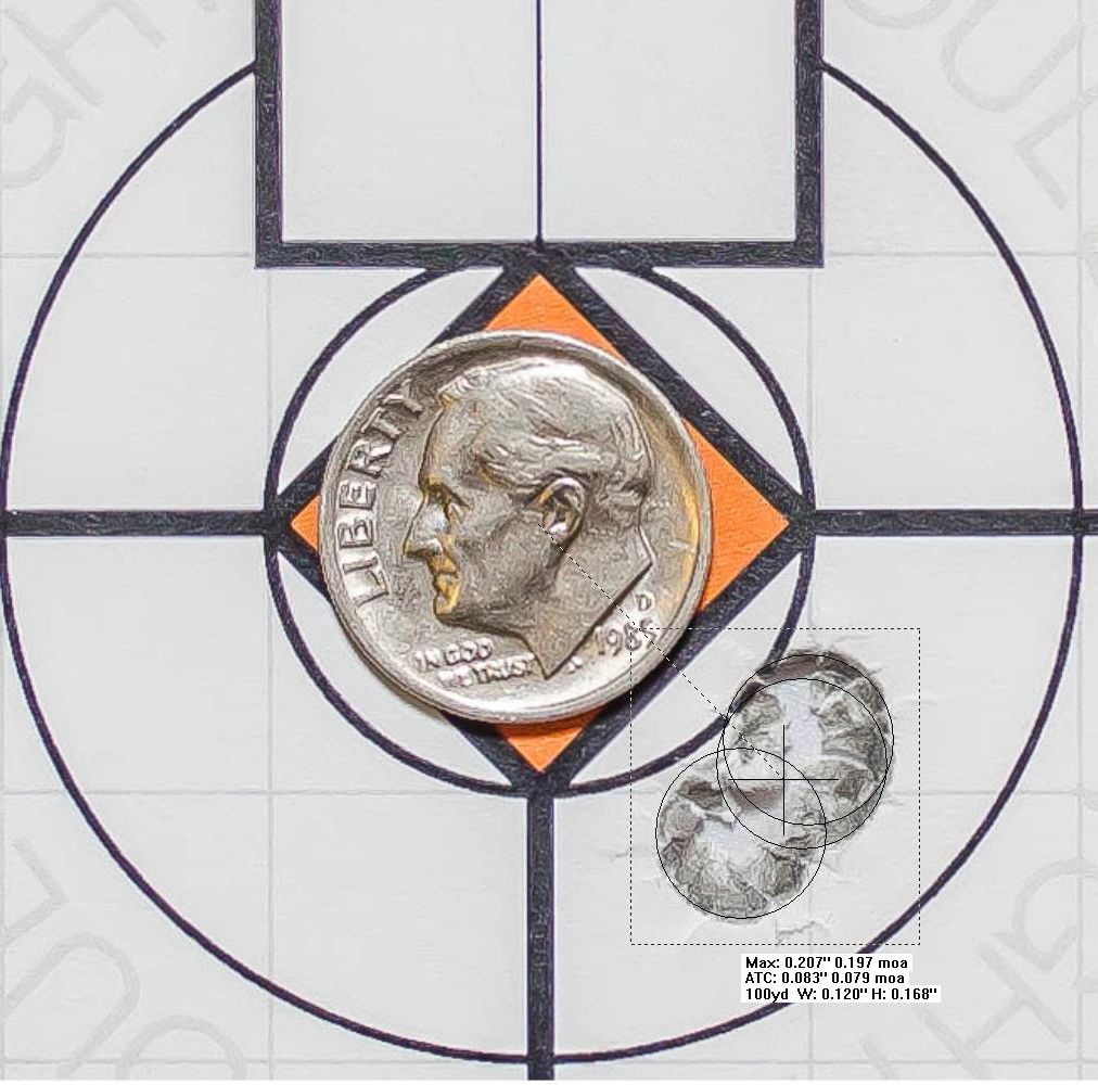

With regard to load data, I am shooting 178 AMAXs seated to 2.925 (still fits in modded AI mag) in Lapua brass with 42.1 grains of Varget. Gets me 2625 fps @ 70 degrees, plenty for 1000 yard action and easy on the brass.
My rifle was a consistent .5moa shooter from the factory, but after bedding & load workup, I have shot a few .1s and many .2s @100 yards. Custom gun performance at factory prices!
Here's my best 5 shot group ever .108 moa:
A few others:
A few others:
